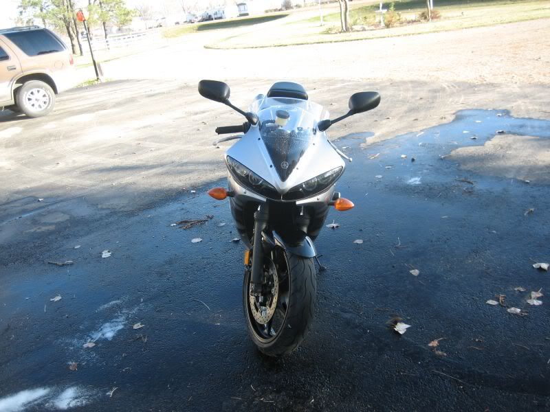

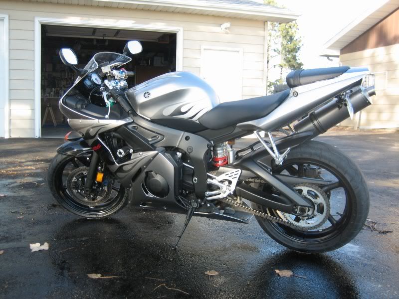

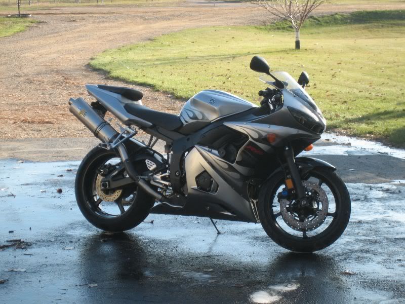

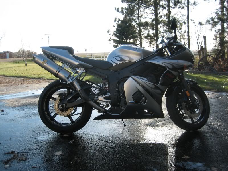

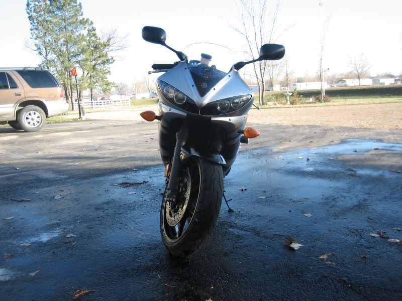

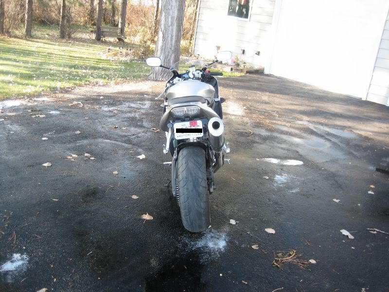

Anybody have an idea of I how I can tell if these are straight? To my naked eye they look straight, but when I'm riding I can't see out of the right mirror without moving my head to the right. (yes I've tried adjusting the mirror) My bike was crashed when I bought it, and it hit on the right side pretty sure it was a lowside that hit a curb or something.... anyhow whatever happened to it the right clip on was broken off, and it looked like it hit hard enough so the left one dented the tank. I'm assuming that in order to go that far it really had to whack the fairing stay.
Here are the only pics I have of it right now. I know they probably suck for trying to see if it's bent.

if you're going for a visual inspection, its a lot easier to see if somethings straight if you put it on a rear stand and point the front wheel straight....

That subframe does look a little tweaked. Take the plastics off and put the bike on a stand, then eyeball it.

Hard to tell from the pics, but actually the rear sub-frame looks a bit crooked to me. If that is the case as it looks, your body would be shifted to the left, possibly making it difficult for you to see your right mirror.
