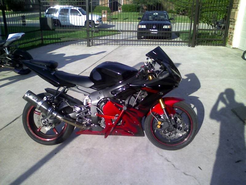

upgrades: 07 r6 front end . have to have the 05 r6 tripples. breaking wave rotors. crg levers. gpr v4 damper
i upgraded to 05 forks originally because someone wrecked my bike so i decided to try and make it work... then recently i decided to go with the 07 forks since they are the same size...
exhaust was from a 07 r6 , wielded on to my midpipe
hope to be getting some wheels soon...
tell me what you think and sorry i only have one pic

cool stuff. So you basically just need 05-08 forks, lower and upper triple, brake calipers and different rotors? What is the rotor size on the 05-08 vs. the 03-04?
I also imagine you would want an upgraded brake master cylinder from an r1 or newer r6.

Actually, I just used the entire '07 front end (except for the throttle side switch pod), tripples, steering stem and all. The only issue I had was the steering stem is a bit longer on the '07, but I made a custom spacer, and woo hoo, instant upgrade!!!

i also do have the dual fans it helps alot and yes i did upgrade the master cylinder to the newer r6 one. if you want to do the switch alot of people sell the 05 or 06 07 complete front ends on ebay
